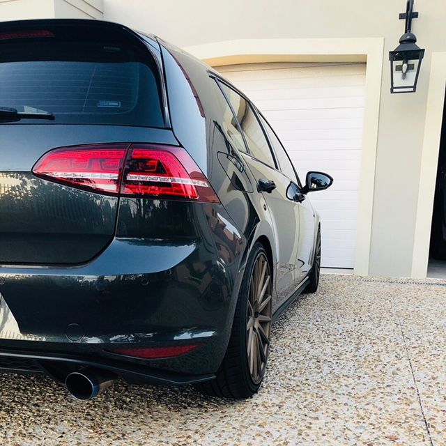

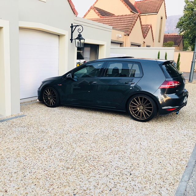

Post by socks199 » Thu Oct 25, 2018 7:39 am
So i have been quite about this build because we have decide to ditch the car. The motor is to unreliable.
So we got a new project car and must say things looking much better now. We opt for a 2015 golf 7 GTI.
So far we have done a Lot
Cosmetics is:
19" Vossen VFS-2
H&R lowering kit
Performance mods:
Armytrix full Exhaust
Rs 3 coilpacks
Rs7 Sparkplugs
CTS intercooler
Leyo Boost pipes
Carbon intake and piping
IS38 Hybrid trubo
DVX STG 3 softwear
This car has made on low boost and pump fuel 314 kw and 520 nm.
We running low boost due to internals not done yet.
