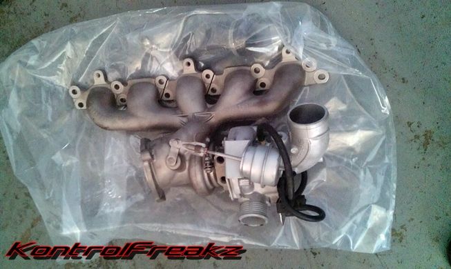

We started off by stripping out the stock turbo, and sent it in for a k04 R Hybrid upgrade with a little in-house secret recipe added..
What she looked like when it got back..

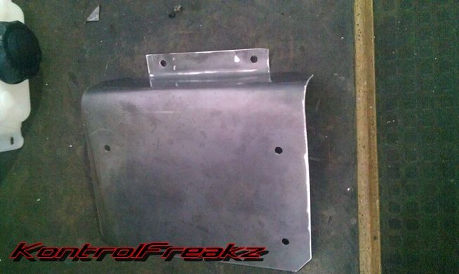

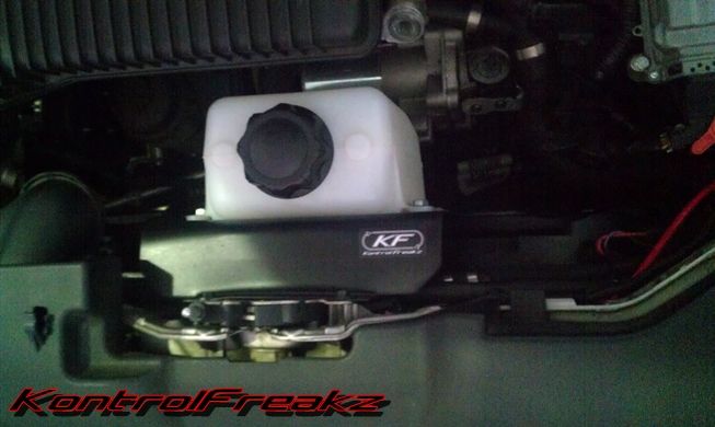

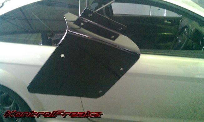

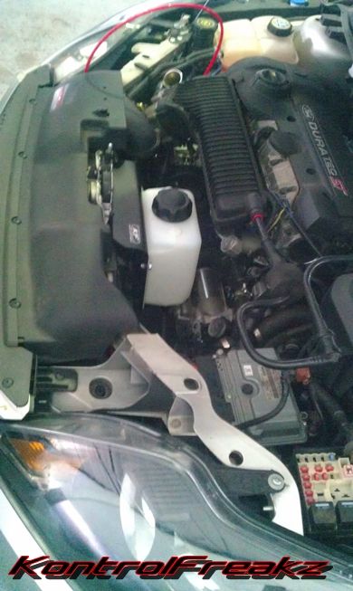

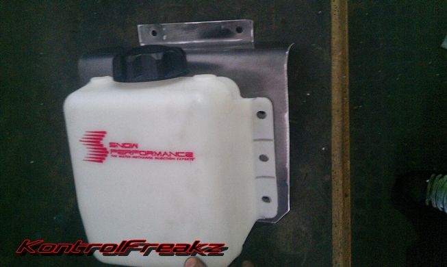

Well,he already had a full 76mm DP and zorst, so besides the HID kit and a full LED kit, we got hold of a snow performance WMI kit, and the installation began, fitting the bottle in the boot, was a big NO for me, as I had a leak in my own WMI bottle once, and meth just don't smell too good, not to mention that it's highly flammable.
We came up with the following:

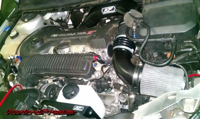

Once the meth kit was installed, we looked at getting rid of all that nasty silicon bends on the make shift induction kit, and came up with this..

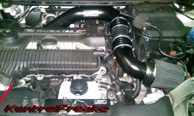

a front lower tie bar was added to the MIX, stock 50mm boost pipes were redone to a much bigger 63mm to company his massive FMIC, and Lechner Tuning came to load a nice little map upgrade for him.

Very nice work with the bottle mount.

Just I question why did you guys install the bottle inside the engine? Or did I look like my ****?

Postby MrMazda » Sun Apr 28, 2013 4:33 pm
Cornel, read the 2nd paragraph below the turbo pic! Something that always worried me, now cleared.

Postby Cornel » Mon Apr 29, 2013 7:12 am
this paragraph that's also stating its highly flammable but its in the engine bay? sorry not dissing or anything I just don't understand and what to learn

Postby ClemR » Mon Apr 29, 2013 7:28 am
Cornel wrote:Well,he already had a full 76mm DP and zorst, so besides the HID kit and a full LED kit, we got hold of a snow performance WMI kit, and the installation began, fitting the bottle in the boot, was a big NO for me, as I had a leak in my own WMI bottle once, and meth just don't smell too good, not to mention that it's highly flammable.
It is highly flammable so it is safer in the engine bay away from passengers and the engine bay is usually well seperated from the cabin of the car so if should something go wrong you are safe

Postby Cornel » Mon Apr 29, 2013 9:53 am
okay I understand thanks for clearing that up. BUT if you don't smoke and the bottle leak you can get it sorted without burning the car. where as it is in the engine bay you car goes kaboem
