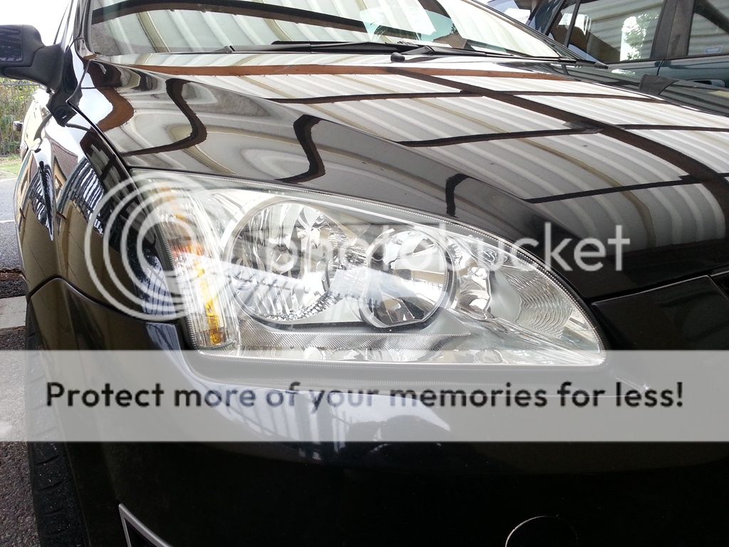

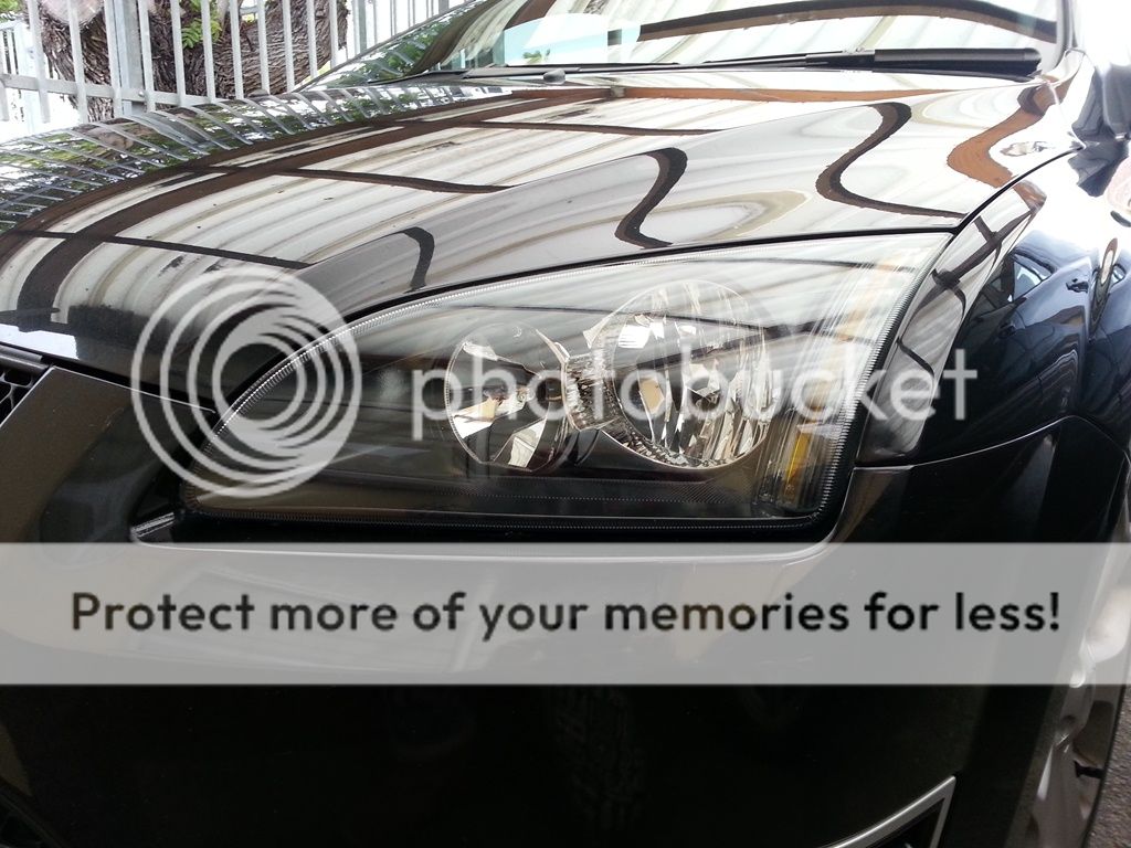

I was bored and decided to black out my lights, was a major pain getting the front lens off cause of the tough glue they used. I havent done the second light yet, so at the moment my car has a black eye lol.
Before
Image[/URL]
After
Image[/URL]

Postby Dizzy » Wed Jun 05, 2013 11:16 am
What did you use to black out the lights?

Postby SerialThrilla » Wed Jun 05, 2013 11:40 am
Dizzy wrote:What did you use to black out the lights?
Grey primer and matt black spray paint.

Postby radmoodley » Mon Jun 10, 2013 2:36 pm
Looks very good! How exactly did you get the lens off if its glued on?

Re: Lights
Postby SerialThrilla » Mon Jun 10, 2013 3:40 pm
radmoodley wrote:Looks very good! How exactly did you get the lens off if its glued on?
Flat skrew driver and alot of patience pealing the glue off, total time was about 2 hours and cost was R100 for both lights. If you want to do it yourself id suggest using a heat gun just to loosen up the glue.
