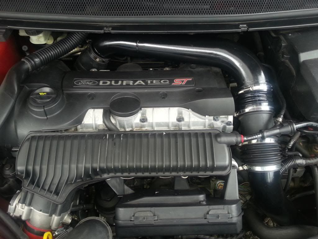

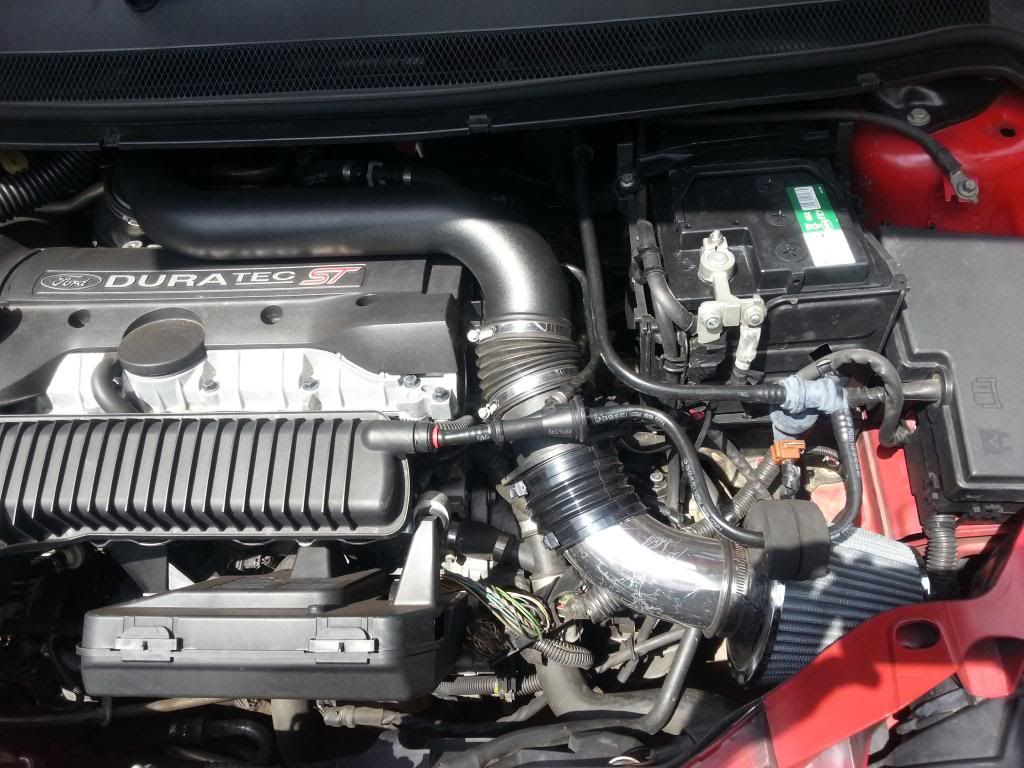

Motorcade Intake it fitted
I still want to change the silicone to red and buy T-Bolt claps.

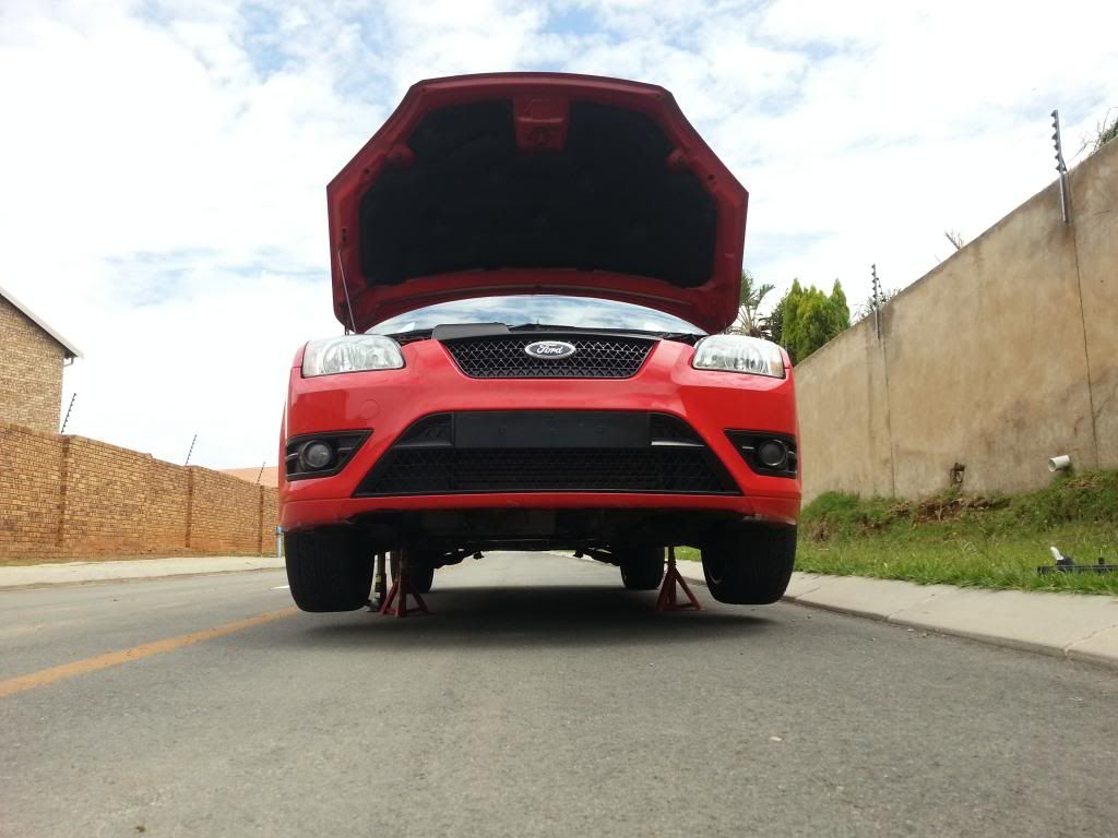

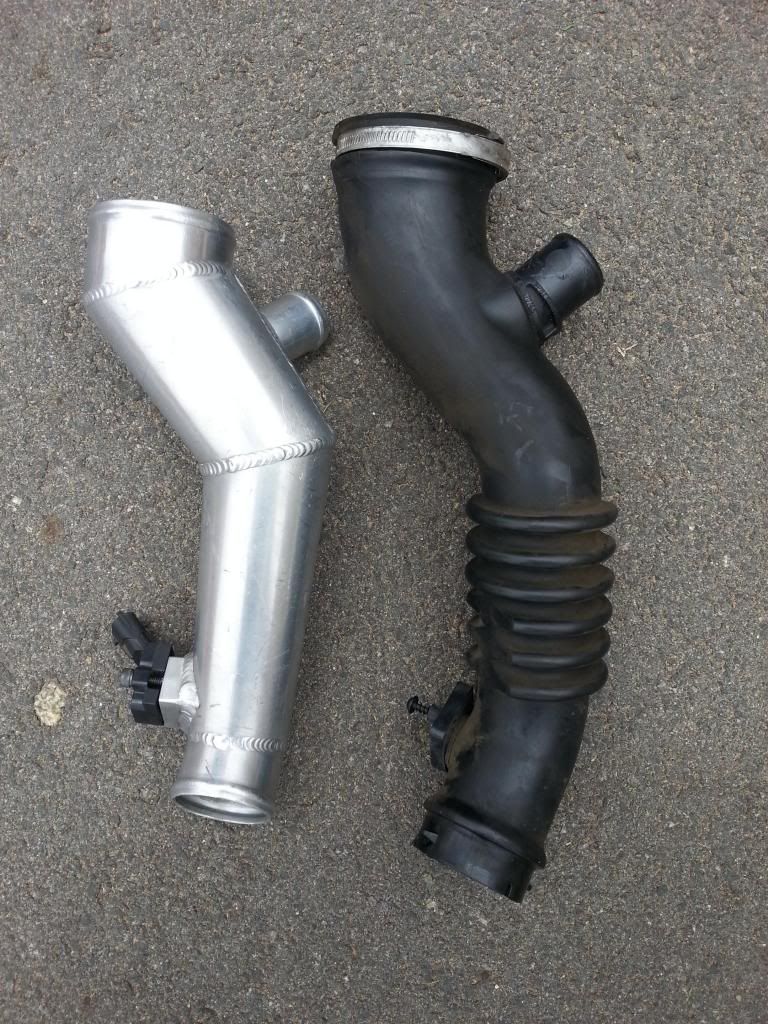

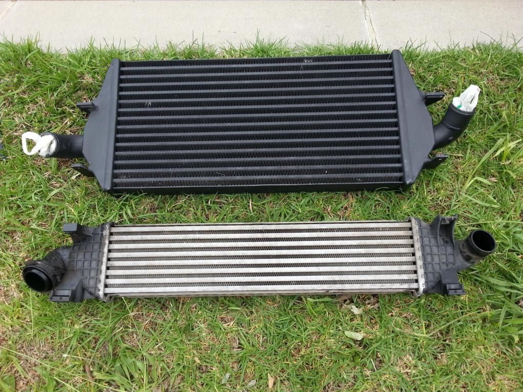

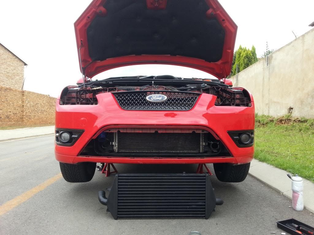

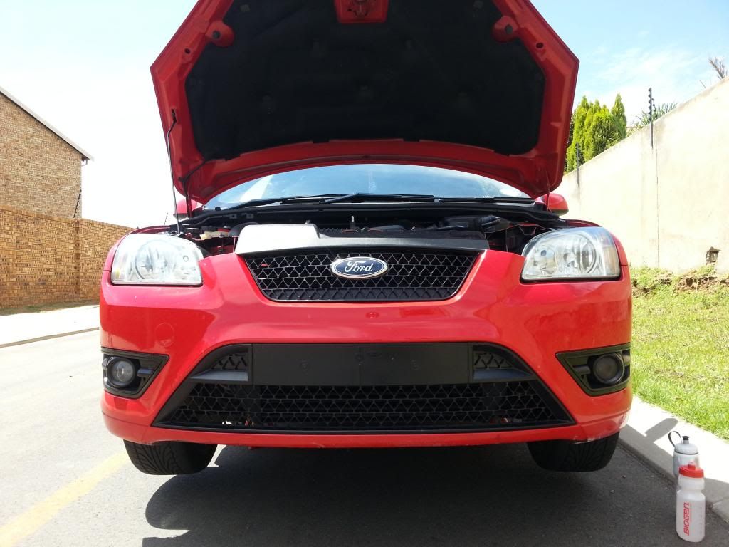

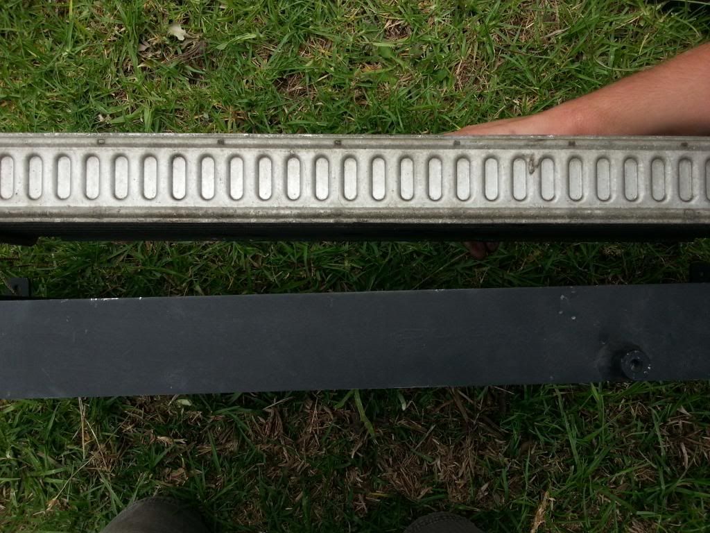

Bought a DBR Intercooler (600x300x76) for the ST second hand from Hano I believe it is bloubul's Old Cooler,So now I can fit the cooler and the Pro alloy cold side boost pipe together.Myself and Brendon from Mas Performance :wink: Fitted it Sunday morning,was quite easy as it is a straight fit.
Here is some pics of the process.
Car in the Air to allow as to fit the Intercooler easy and without headachs
Stripped
Core
Pro Alloy pipe next to the oem Plastic one
Fitted
I ran logs Before and After cooler was fitted.
Before cooler after 2 runs the intake was 72 Degrees After intercooler 4 or 5 Sprinted runs the inatake temp was 47 degrees.

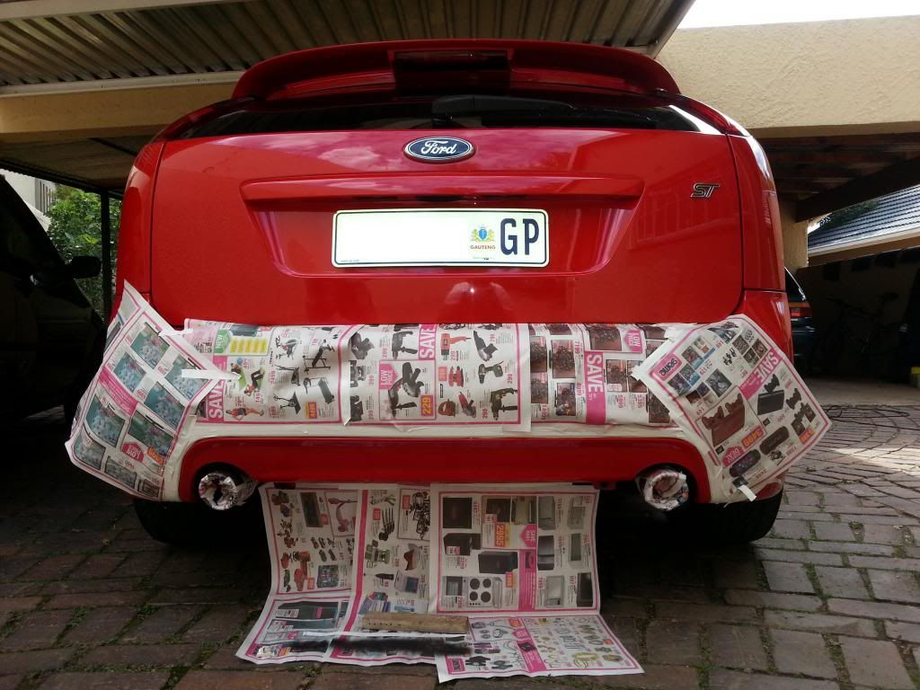

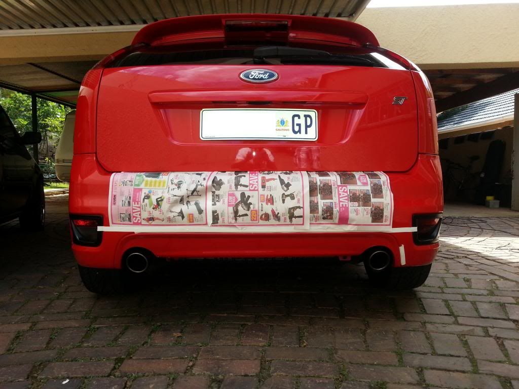

First mod for the year one of my mates came over and we gave the ST a nice was and some Meguiar's loving.after that we sprayed the rear apron gloss black as well as the front lower bumper.
Here is some before and after pics.
