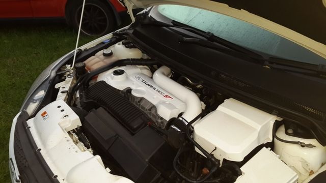

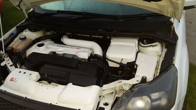

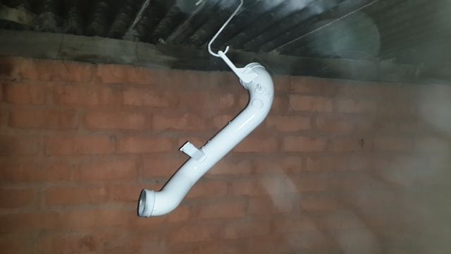

Mod6: Engine bay plastics gloss white (UPDATE)
So finally got to it this weekend. Sorry for the dirty engine bay :?

@ Shaun
Ya you know it! :lol:
Still have to see if the paint will hold up to the heat though. I have my doughs!

Postby Shaun75 » Mon May 26, 2014 1:41 pm
JC ST wrote:@ Shaun
If you got a heat resistant paint, then it should be fine.
Engine bay doesn't get nearly as hot as brakes for example... (Although that is special caliper paint).

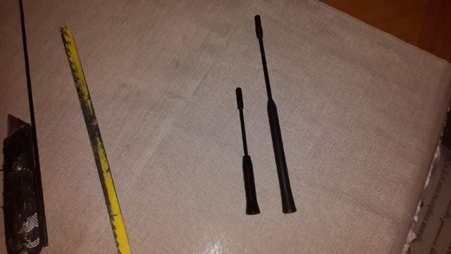

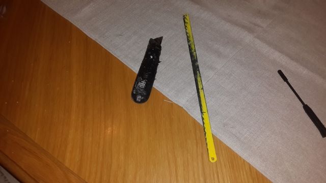

Update of my 1 'ST' mod.
So with the shorter B-Sting came very, very poor FM reception. So had to do something!
I took my standard B-Sting and shortened it. Reception is a million times better.
What you will need:
Carpenters knife
Hack saw/blade
Cup off boiling water(must be a Top Gear/Stig cup)
Sunlight liquid
Teeth
Patience

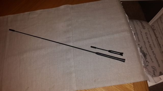

Before:
First cut through the fiberglass surrounding of the antenna @ your desired length.
Saw the copper rod that is left over.

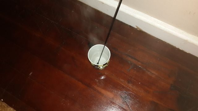

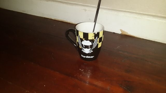

To remove the rubber/plastic cap @ the end of the original antenna you will need a cup of boiling water.
After +- 3 min in the boiling water remove the rubber/plastic cap( I used my teeth but not recommend)
No to replace the rubber/plastic cap back on to your shorted antenna I used 1 drop of Sunlight liquid to help the cap to slide over.
After:

Oh and please use some masking tape or something on the side you are going to keep before you start cutting it.
Just to prevent the black fiberglass to splinter.
