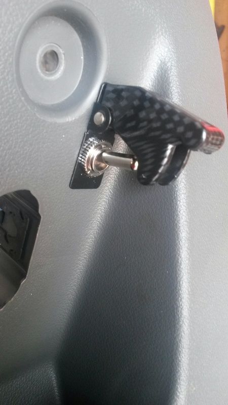

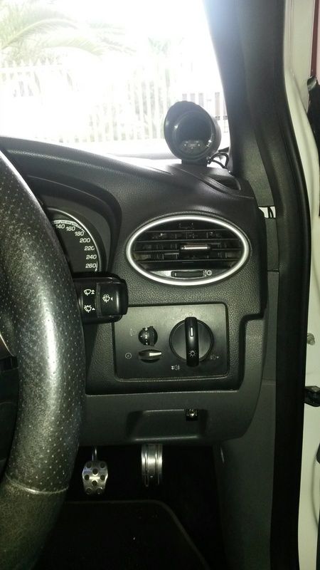

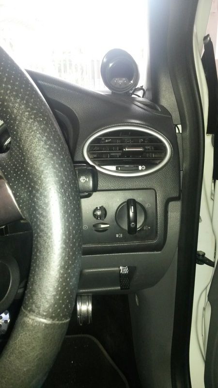

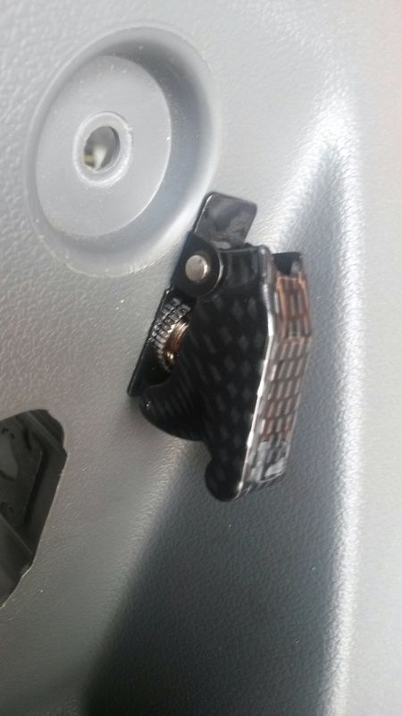

I put the switch near the OBD2 stock location so it's nicely hidden and easy to access.
Image Image
Image Image

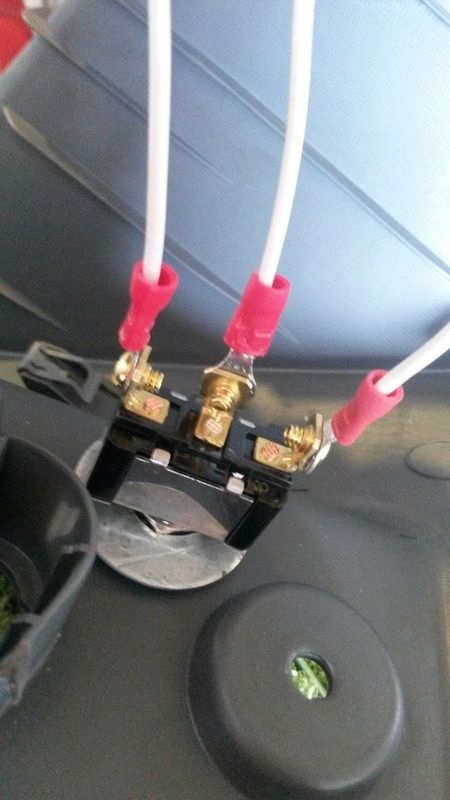

Wiring it is easy, connect cable power of both harnesses coming from the adapter to center of the switch, and then from each of the out side connectors connect a cable to one harness each. This will pull power away from one when the other one is in use. I put it that when to switch cover is closed power is routed to stock location and when cover is open and switch is up the bluetooth adaper switches on and oem location off. 8)
I know its geeky but hey, its super cool at the same time. 8)
