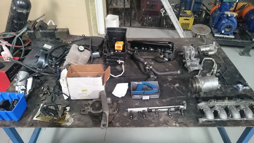

First step was taking out the engine, I never took any pictures at this stage but here she is on our lift during the process.

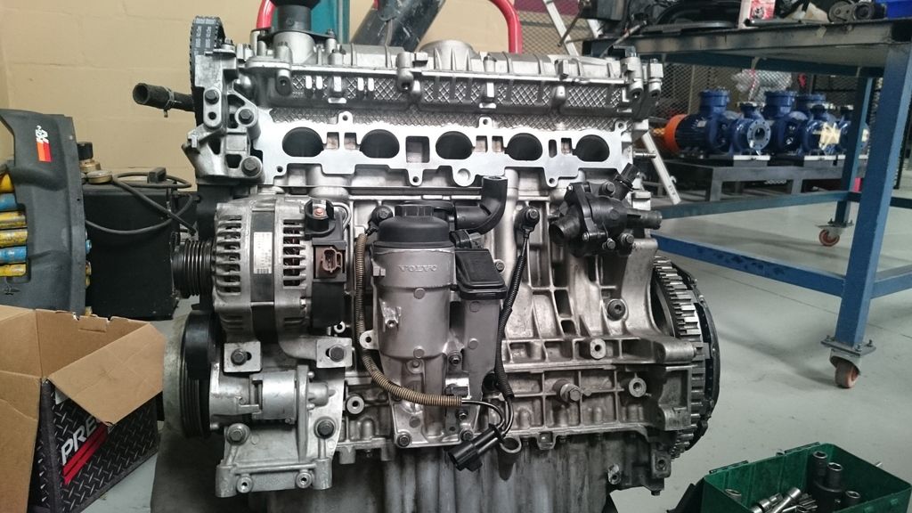

Took a while to get some parts for the turbo setup but mad scientist Zain made quick work of the engine, this guy really is a master and it means a lot to me having him do the engine.
The sub assembly specs are K1 rods, Wossner pistons and Darton sleeves. The head studs are ARP non stretch and using a RS head gasket. While waiting for the turbo goodies I decided to tidy up where I could, cleaned the gearbox as well.

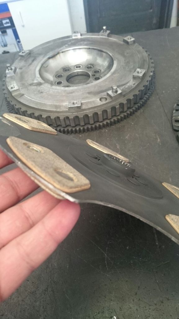

Had new buttons put on the clutch as well

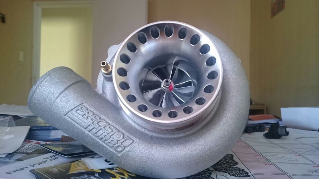

Then some parts started rolling in. My choice on the turbo was a 5858 ball bearing with .63 exhaust housing. I wanted a quick spool up for everyday use and just wanted a nice punch above k16, I thought I would regret not going a bit bigger but at the moment I am still very happy with the way she responds low down.

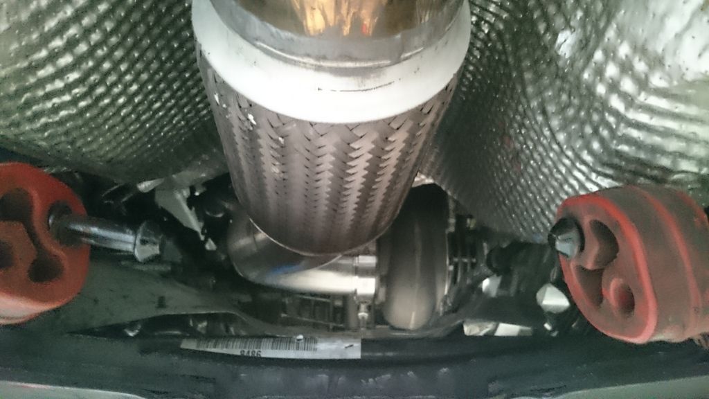

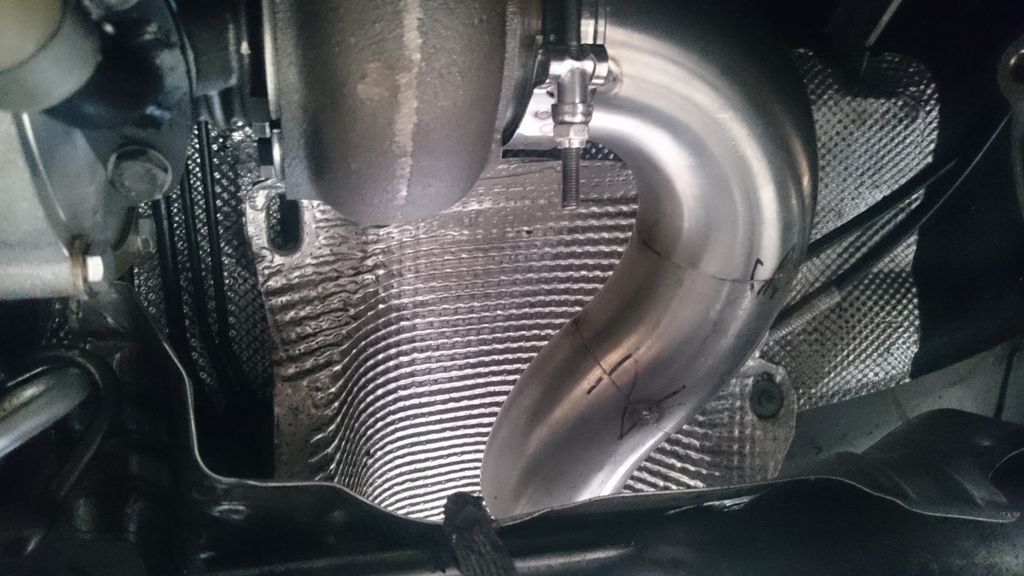

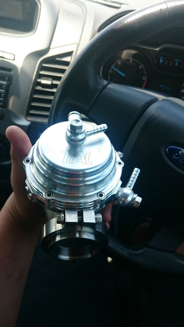

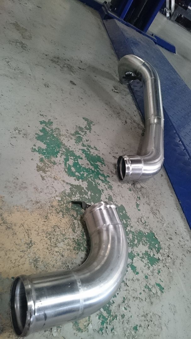

It was now time to for the downpipe, wastegate and boost pipe to be made/ modified so we did all this in house. All connections use v band flanges and the wastegate pipe can be removed separately from the downpipe! Trial and error was frustrating but we managed to put together something that I was very happy with.

Back to the Ford hahaha, exhaust lined up proper after everything was tightened up and happy chappie I was.

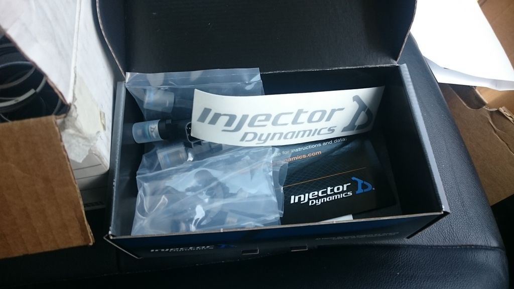

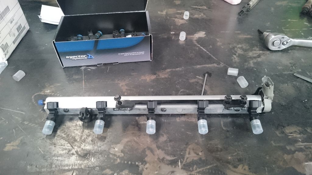

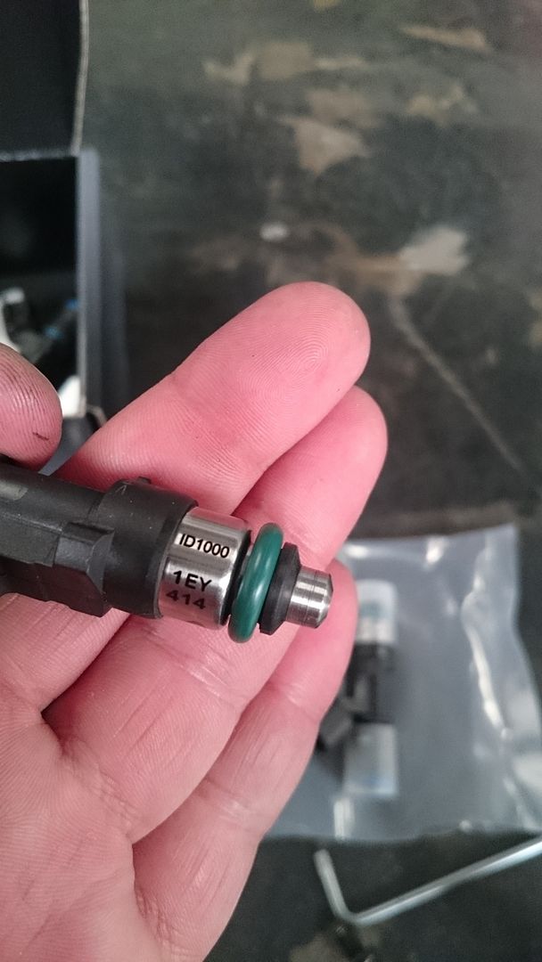

Bigger injectors that dubs organised for me, if Dubs says they good I trust him 200%

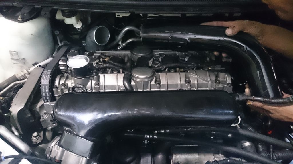

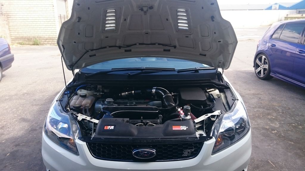

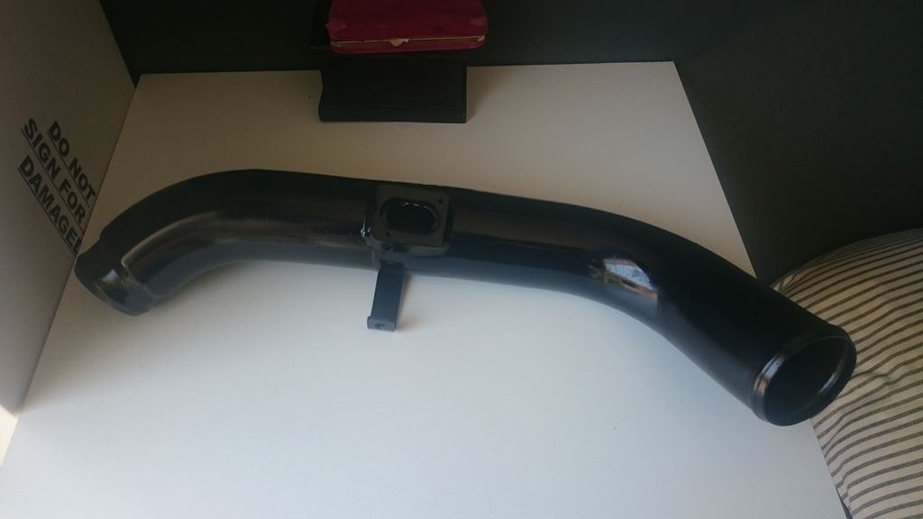

Intake supplied by hano, top service, just such a shame it had to be cut and modified to fit but I knew this would be needed as I told Hano it was fine to make one according to the stock location. I didn’t want a stainless steel intake hence opting for one from SAIC.

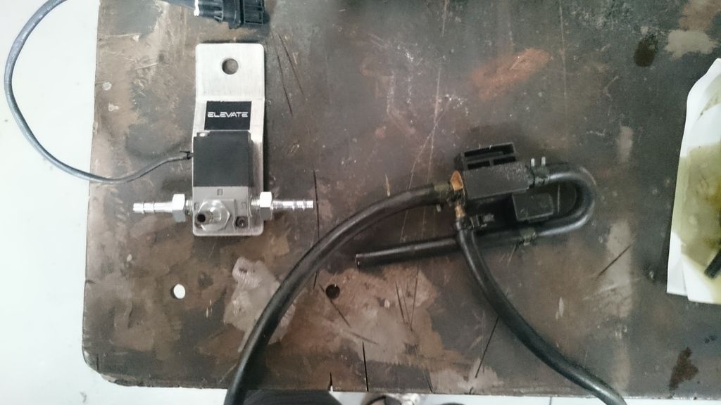

Loads of additional stuff was needed which I didn’t take pictures of. Here is one of them; Uprated n75 from Elevate. I converted to RS map sensor as well but had one lying around for a year which I knew it would come in handy.

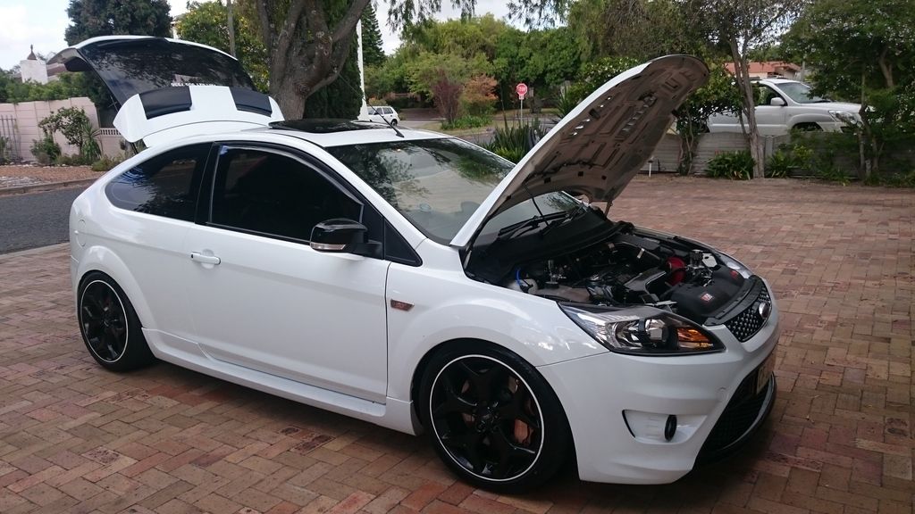

So good having her home again but she needed a major wash, reverted back to stock wheels for normal street use with some new potenzas I bought a long while ago.
Still need to finish off a few cosmetic stuff in the engine bay such as respraying the intake, etc. but that can all wait.
But she was out and about and I was more than happy!
