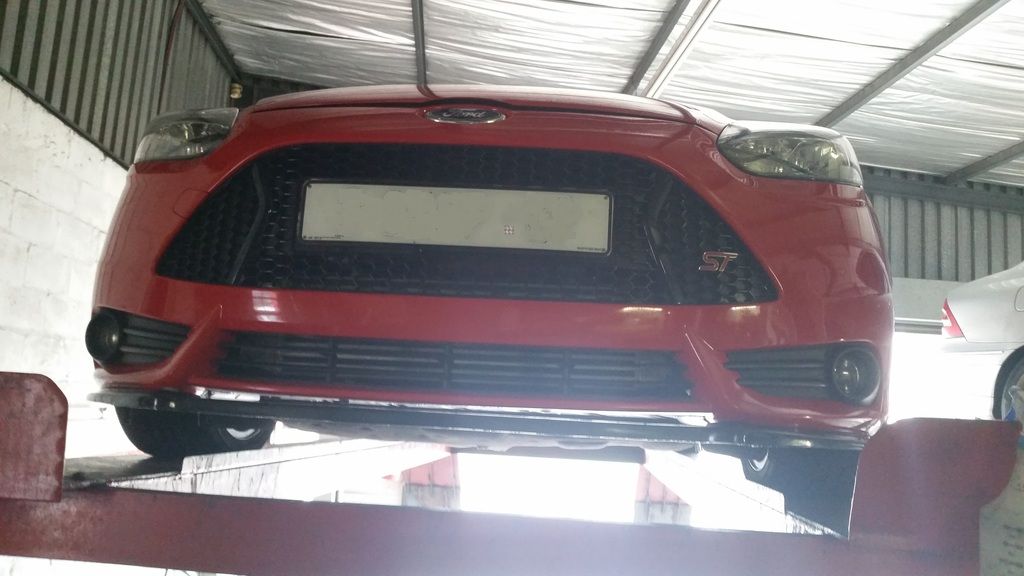

Oky so here it is the 1st start for me in the new engine.

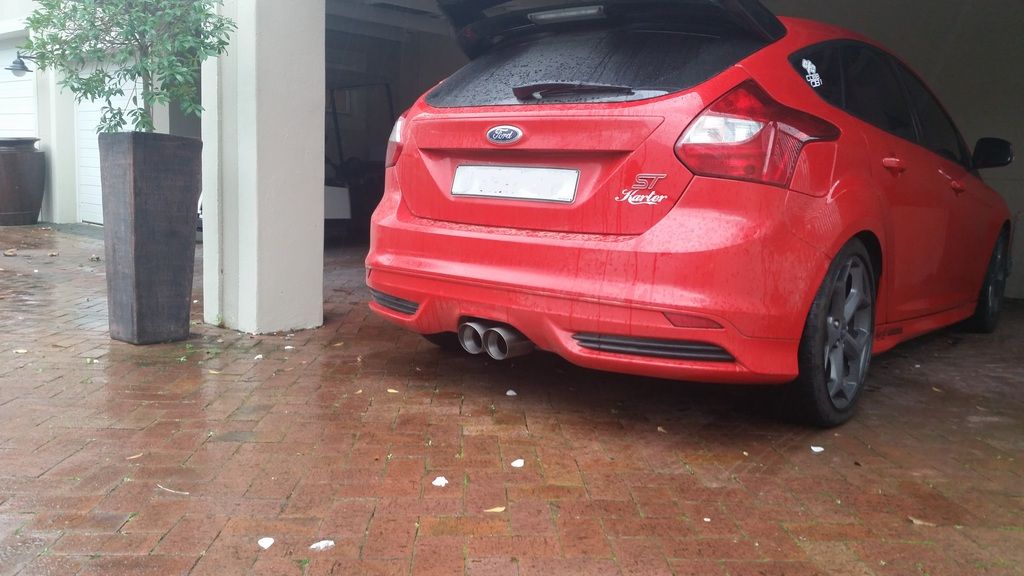

Getting her new noise makers install

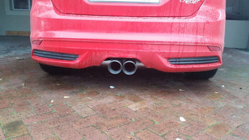

After shot
Close up
