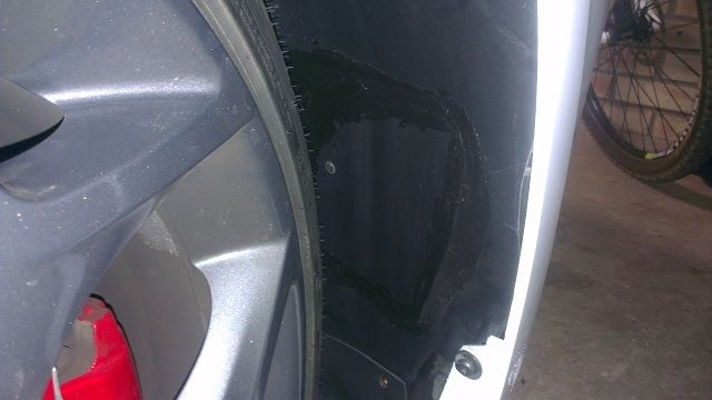

I recently replaced my wheel arch liner because my stock one was damaged - unfortunately I manage to damage my new one as-well because the HID ballast was to close to my liner causing it to melt - I have relocated the ballast now and all is fine.
I did not want to spend money again buying a new one and did the following repair which I think looks ok and does the job:
Pic of the damaged liner:

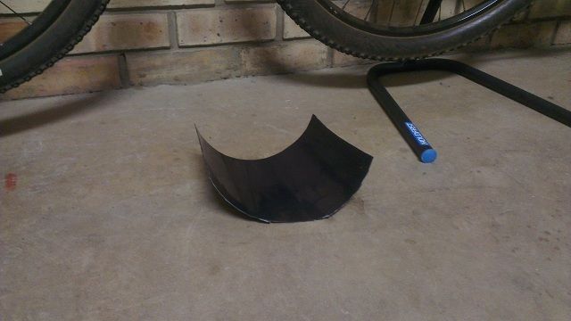

Use an old bucket or buy new one, they are +- R15:
Next cut out a piece of plastic from the bucket bigger than the damaged area on the liner:

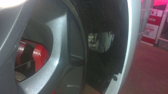

I then applied epoxy glue on the outer edges of the cut out bucket part and glued it over the damage area. After about 15 minutes curing time I went over the "bucket" plastic edges with black car silicon just to seal everything:
