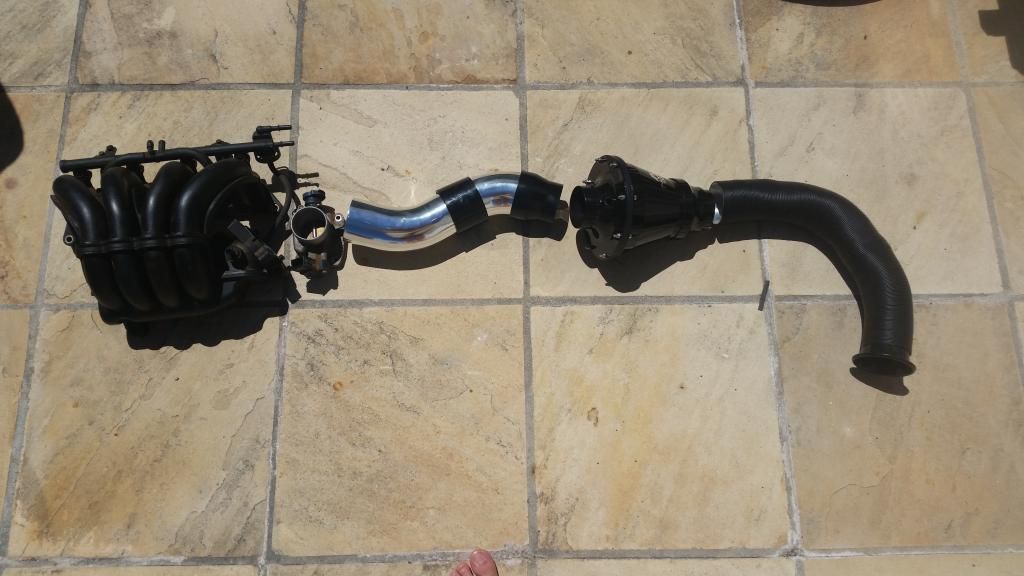

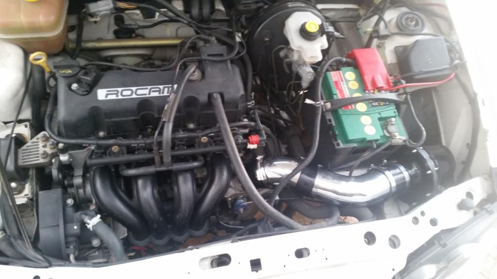

Postby Eon » Mon Nov 03, 2014 1:36 pm
Looks like I'm talking to myself here, so I went and did it anyway.
The results were... well, to be honest not so great.
I tried the 1600 manifold with the stock airbox attached, and it didn't feel any faster, maybe even a bit lazier. I blamed it on the ECU still 'learning' the new intake because I had the battery disconnected during the whole operation.
After that, we did the induction. I didn't have enough bends and fittings to do a proper CAI, so I just made a normal induction pipe with the K&N Apollo filter attached. It sounds mad, but I'm still not too sure if I made any gains.
Here's the final product
This brings me to my final question: Will a remap (R600 @ KSD) unlock the benefits of these mods, or am I better off with the 1300 manifold?
