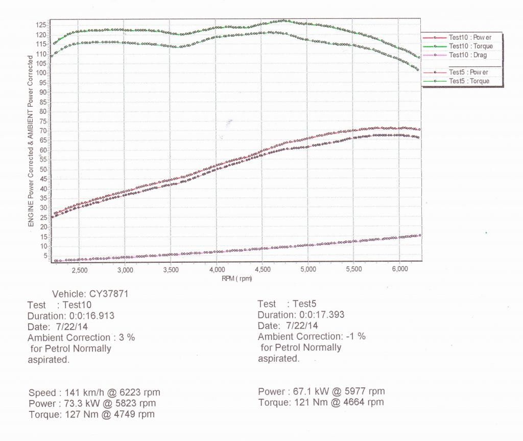

Sorry to hijack the thread a bit here, but while we're on the topic of dyno figures;
You're telling me that the 4% difference in ambient correction equals 2.8kW.
This means that when I brought my car back for a remap after the (expensive) head jobbie, the 6.2 kW that was gained on paper, was actually only 3.4 kW? Thus, should the test be conducted under -1% ambient correction again, my car would only have made 70.5 kW? ](*,)

In essence yes, how much time elapsed between Dyno 5 and Dyno 10?

I dunno, like 30min at best?

If that is the base then they have definitely changed the correction factor to give you a false reading. The chances is very slim that the environmental factors changed in 30 minutes to warrant a 4% change in the correction factor.
