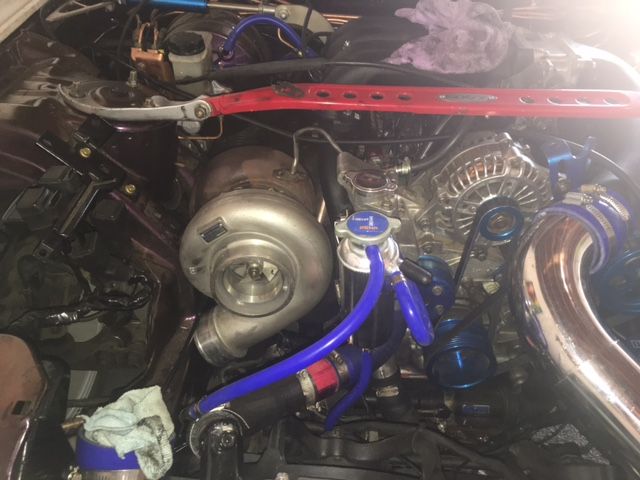

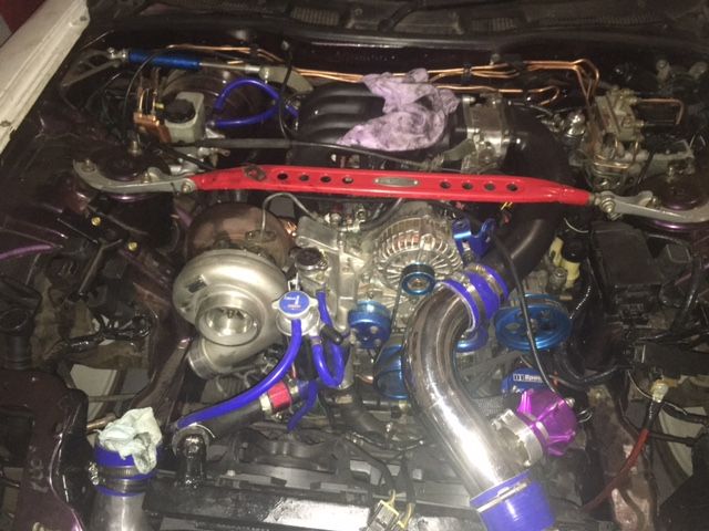

Postby Ruff » Tue May 17, 2016 3:55 pm
Pics with the turbo tested fitted below.
Just need to spin the exhaust and intake housing so that the oil return and feed are in the right location as well as the intake exit pipe for the boost pipe to fit to the intercooler, will be fabing up a 100mm downpipe as the new exhaust housing is 100mm to fit the rest of the exhaust which is 76mm with a V Band on downpipes and decat, should give me a better spoil rate and as the turbo is twin scroll and my manifold is also made up for twin scroll should see boost building from 3000rpm :)
sorry for the poor quality pics, was in a bit of a rush.

Re: Mazda RX7 FD3S Build
Postby V6 Capri » Tue May 17, 2016 4:15 pm
Geezzzzz. you have small hands hey?!?!
:lol:
Nice turbo that!

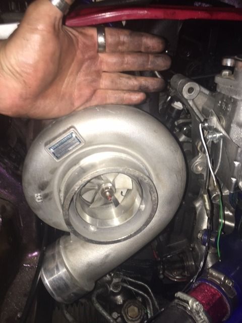

Postby Ruff » Wed May 18, 2016 9:35 am
Some better pics of the size of this beast turbo.

Postby V6 Capri » Wed May 18, 2016 10:27 am
Turbo packs more cc's than the motor! :lol:
Looks wicked in the engine compartment though! 8)

Postby Ruff » Wed May 18, 2016 10:37 am
V6 Capri wrote:Turbo packs more cc's than the motor! :lol:
:lol: I think now I should reach my goal of 500hp on the wheels with ease :D
